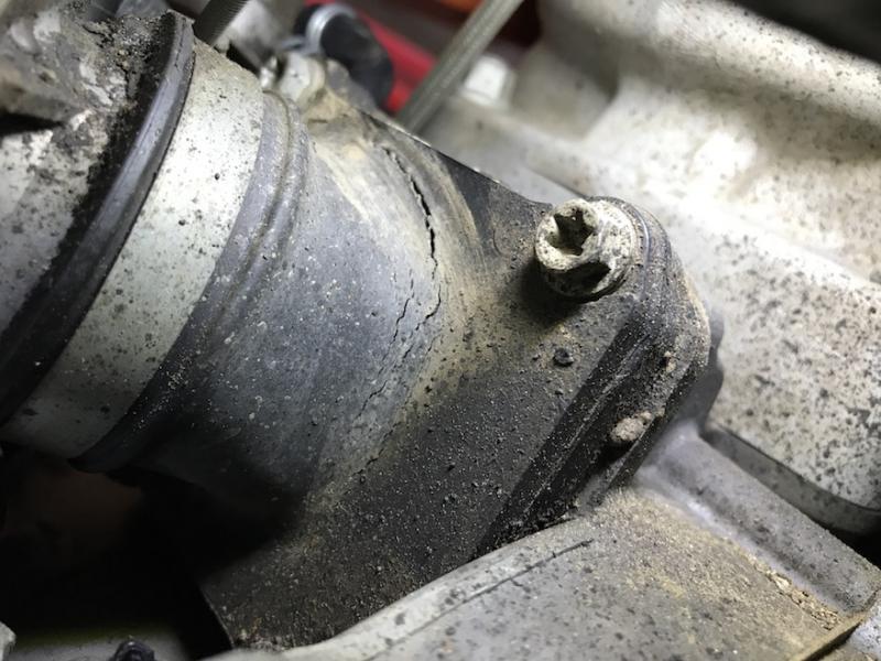

    Yep, I can definitely feel it when I open & close the throttle. It snaps nicely. I took a peek at things, and the only thing I can think of that looks maybe suspicious is the carb intake boot. The bike has a Moto Tassinari reed valve system, probably this one. The OEM intake boot looks a little dry rotted, but I think it's always been like that:
    Could that be my problem? Interestingly, the Moto Tassinari kit requires you use the intake boot from an SX bike, even if you've got an EXC. A new boot is only $23, but disassembling everything to get to it would be a pain.

    That boot almost looks like somebody tried to seal one of those dry cracks with a fingerful of silicone, no? Either way, that's only going to cause future woes.
    That's actually a good point. I was poking and prodding in there but I don't know if I made that smudge or if the PO did. He was a hamfisted fuckhead, so the money is probably on him.
    I have to order some stuff anyway from RMATV so I guess I'll get another boot. The new (OEM) bodywork doesn't fit properly, but that's another story...

    Oh hell yeah replace that boot.

    I'll order one tonight. Do we think it's a potential problem? I guess I could put some electrical tape over it and start the bike, that might seal well enough to let me know if it's the issue or not.
    I really don't want to run the thing for long because I'm afraid I'll blow the motor.

    Start the bike, spray that area with brake and parts cleaner and see if it responds.

    I tried covering up the crack in the boot with electrical tape. It seemed to make a little bit of a difference in that the idle went down. I tried spraying it with carb cleaner after removing the tape, that made basically no difference.
    I'll order a new intake boot tonight.
