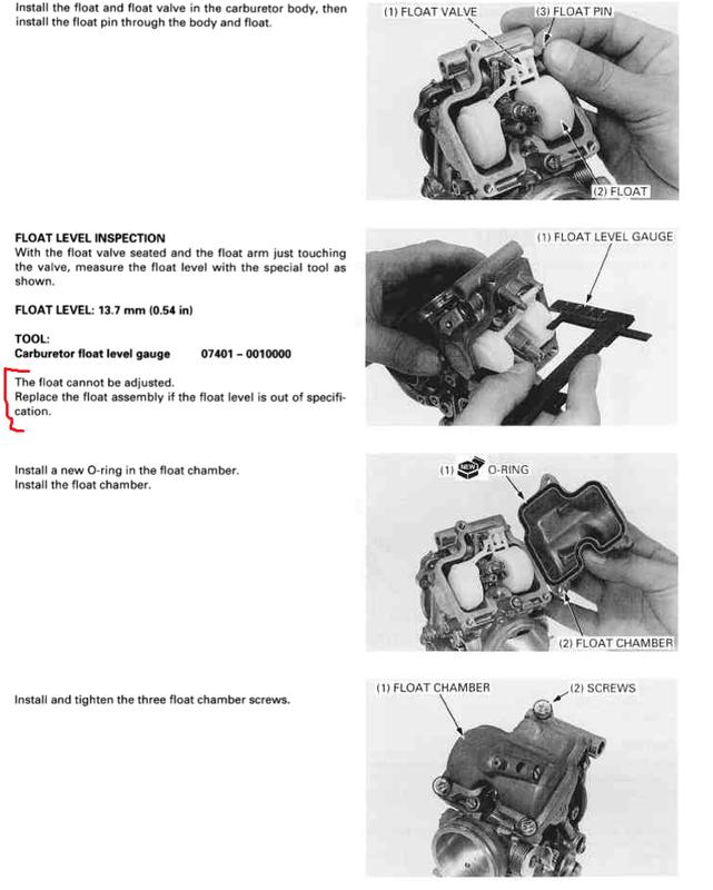

    Heres a bad ebay pic of the floats.
    As you can see, the entire float is plastic and the two "towers" that the dowel pin slide into are cast into the carb body.
    The manual I have doesn't cover my year, it's for a 95 but it still says the float height cannot be adjusted.

    Re: Bike dies when I put the airbox on
    Bike dies when I put the airbox on-lolhonda-jpg
    Boom head shot

    Surprising to see them all plastic. Is it possible you may need to replace the floats then? Italian bike owners know all to well what ethenal does to plastic
