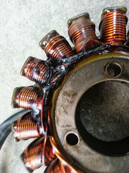

    Re: Bad battery or bad rectifier/regulator?
    If the stator output is correct, it's good. They don't get affected by heat etc.
    Really?

    Re: Stators. My understanding is that they are bathed in oil to help cool them. Run your oil level just a little bit low in some machines (ex: SV/DL650) and there isn't enough oil to keep it cool. Combine with the right load conditions and the stator can burn through the coil insulation and short.
    Mine had a short. Not across the whole coil, but somewhere in the middle. Its resistance was close to spec. It did not put out the spec'ed voltage on 1 of the 3 coils. I opened it up to find what you see in the photo above.
