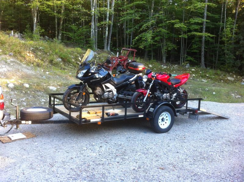

    That's a 6.5'x12'. Yes, there are 3 bikes on there.
    I'll let you know how it works. It is leaving for Deals Gap tomorrow night like that.

    It was just a staging setup so I could figure out where to put the chocks (made of 2x4PT btw, no need for $250 Condor chocks). No tie downs, but I have 3 runs of 10' e-Tracks to anchor to.
    They will be strapped in tonight.

    That trailer is borrowed, but basically lives in my yard now. Worthington 4x8. Were I spending money I'd get something between yours and mine; 4x8 (maybe 5x10), stake side, but with the ramp.
    Although there isn't a chance in hell a trailer this size would fit three bikes. Not with the wee aboard anyway.
    I wonder if 5x10 is enough for three mid-sized sport-ish bikes.

    Not sure I would tie down the bike to the wooden sides. Don't you have tie downs on the floor?

    Image is deceptive. Tie downs are hooked to the aluminum frame of the trailer under the stake-sides. There are no tie-down hooks in the trailer itself.
    I fully admit to going a little buck-wild with the straps. I don't tow bikes often and really did not want to be that guy and fuck up that clean, nearly new bike he just bought.

    haha, I hear ya. Look into retractable tie downs or racing straps with soft loops. Those cheap harbor freight fabric tie downs will flop about everywhere, catch on your wheel one day and bring the whole party to a halt (ask me how I know).
