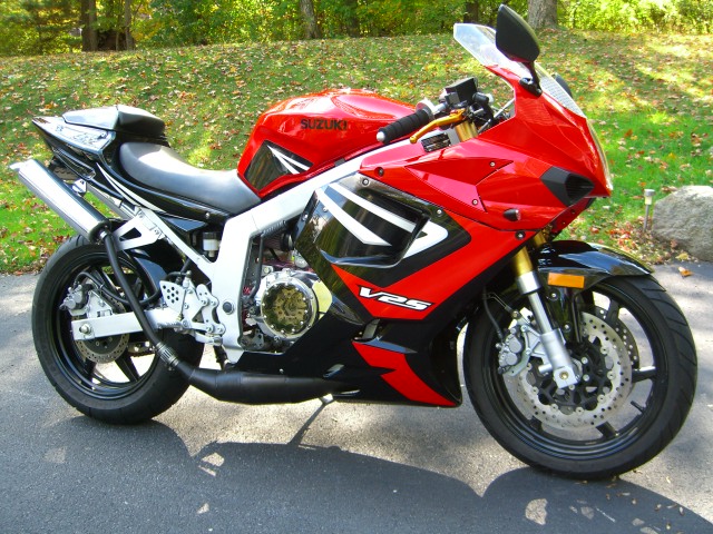

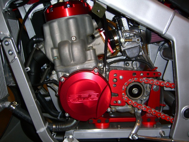

    I didnt think the quadzilla was counterbalanced.....Thats why i opeted for the cr250... I put a cr500 in a streetbike... I did the best build ever for this attempt... just to much vibration, even with custom fully isolated rubber mounts.... the body cracked, mirrors rattler bad...dont get me wrong, I could have continued to work on it but it just sucked to much.
    Ninja 250 motor transplant... what motor to use?-cimg1164-jpg
    Ninja 250 motor transplant... what motor to use?-bike_finished-jpg
    then converted to a 115hp banshee motor
    Ninja 250 motor transplant... what motor to use?-cimg2828-jpg
    banshee was the way to go.... smooth and fast!
    The rd motors are to low tech... plus they have 2 cyls/ pipes... trying to make it light.
    The cr250 has 48 HP....the stock 250 ninja had 24hp.... I have a cr250 motor now... im leaning this way heavy as I can get cr250 motors everwhere cheap. The quadzillia motor is very hard to find.
