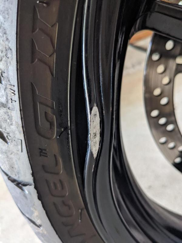

    Riding my Multistrada earlier today and on S Schoolhouse Rd In Leyden, about 500ft before the Greenfiled Rd intersection I hit a huge pothole that bent the hell out of my rim. Normally I avoid potholes, but this particular one was on a 15mph right turn with trees throwing shade over the pavement, it was basically dark around that turn, wasn't going that fast because I knew the intersection was coming up. Jacked up my arm and put me out of the seat a little, thankfully nothing major like getting thrown off and dumping the bike. I wasn't too far from home, limped back on Route 2, took little over an hour.
    Did a search here but all I could find were a couple of threads 10 years old that mentioned Wills Rim Repair and another place in AZ, the AZ place might be an option, and Wills seems like he is out of business. Anybody know of a place in New England that fixes bent rims? Internet search doesn't give me a lot of hits except a mobile car rim repair place in Groton, called but but no answer. A front rim from Ducati is $1831.00, so would like to try and fix.
    Here is a picture. the scraped part is from where the bent rim was hitting the front brake line, right before the banjo bolt.
    Bent Rim Repair-wheel-jpg

    I have taken stuff to McWheel when he was in NH, but he is in AZ now, the wheel you show in the pic is easily repairable

    Thanks, that is encouraging knowing it is fixable.
    WAs thinking of banging it with a rubber mallet to see if I can make any progress.

    For what its worth, I tried pounding on an aluminum car wheel with a hammer and a block of wood, it straightened out the lip but cracked the metal and I then had to get it welded....

    need to heat it up to avoid what Xrocket21 said, sure it's possible to do yourself, but I kinda look at this type of work as "art", as there is no correct temp to heat to or no correct amount of force to hit the wheel without damage. With experience you just know...

    back when McWheel was in NH, I hung around and watched em do a wheel, he banged on it with a hammer as he spun the wheel on his machine, just feeling it by hand till he stopped, and put the dial indicator against the wheel, it was within .01" all the way around, all by eyeball and feel
