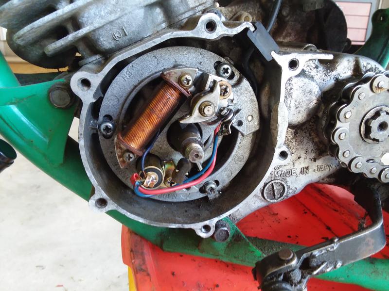

    80s Suzuki DS80 rebuild has begun!-20200721_071750-jpg
    80s Suzuki DS80 rebuild has begun!-20200721_071834-jpg

    New condenser in, still doesnt start. I learned the coil wire was wired directly to the points, skipping the condenser, because I could see the old broken wire.
    I sanded the points a bit.
    Spinning it with my impact I get like 300 mvac which clearly isnt enough.
    Trying to watch youtube vids on points to try to figure this out.
    this says .019 gap
    https://answers.yahoo.com/question/i...tjN2yJB8byBkN3
    but where? At TDC? i dont friggen know.

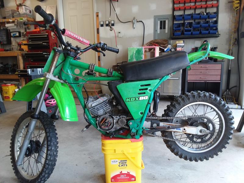

    Well, I did the JB weld putty and I think it worked pretty great! I also got the sprocket and chain, rear brake, front brake, airbox, and cleaned carb installed. Literally all that is left now is to get spark and put fluids in.
    I ordered a set of points on ebay, hopefully that will do it.
    80s Suzuki DS80 rebuild has begun!-20200726_173127-jpg
    80s Suzuki DS80 rebuild has begun!-20200726_173132-jpg
