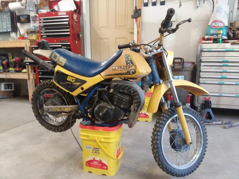

    The start!
    80s Suzuki DS80 rebuild has begun!-20200527_160809-jpg

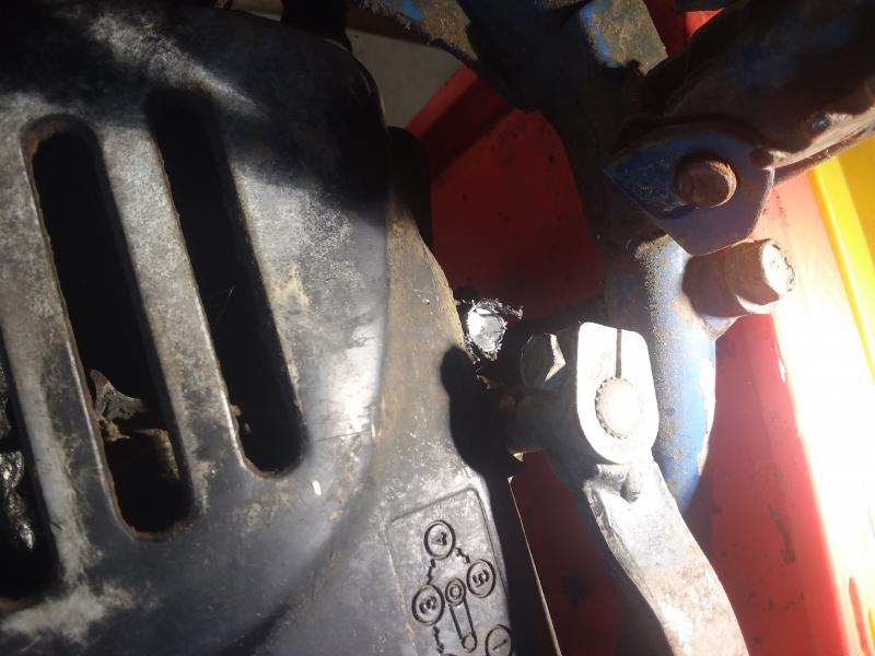

    Of course had to drill out a bolt. These Phillips heads will be replaced with stainless hex head.
    80s Suzuki DS80 rebuild has begun!-20200527_182827-jpg

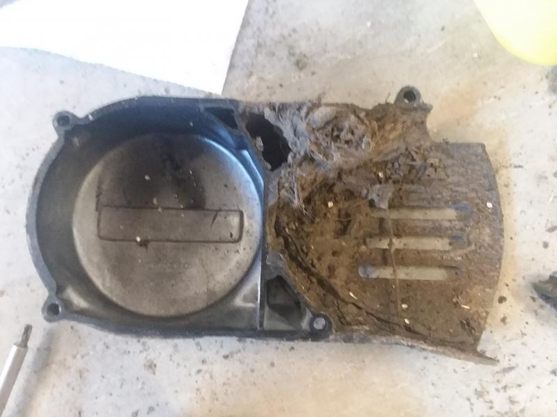

    This old girl hadn't been cleaned for years then sat for a decade.
    80s Suzuki DS80 rebuild has begun!-20200527_184253-jpg

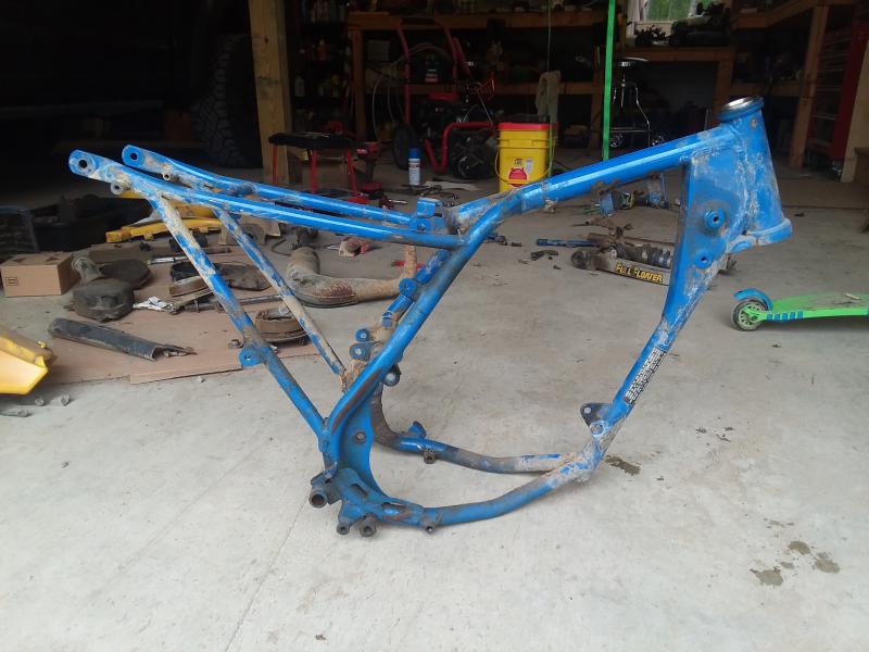

    How it sits now
    80s Suzuki DS80 rebuild has begun!-20200527_193032-jpg

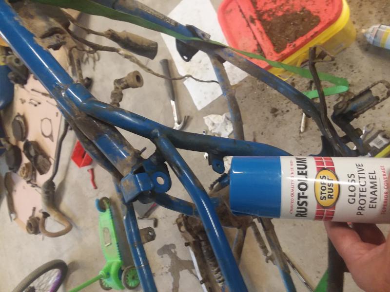

    I plan to clean up the frame and hit it with blue rustoleum
    80s Suzuki DS80 rebuild has begun!-20200527_194053-jpg

    Get yourself an impact driver, and a set of JIS screwdrivers, you'd be amazed how many of those stubborn 'phillips' head screws you thought you'd have to drill out come out without any drama after.
    TWINS! xrocket21's Avatar
    Central Maine
    7,870
    Re: 80s Suzuki DS80 rebuild has begun!
    I don't have official JIS this big, but I tried drivers of various home grinds. I also hit it with the impact driver with no luck. Of course it was the one partially obscured by the foot peg so I couldn't get a good purchase on it. I should have hit it with the blue tip wrench, but I thought the cover was plastic. Got the head mostly cut off with my dremel, but the battery died of course. It drilled out in pretty short order.

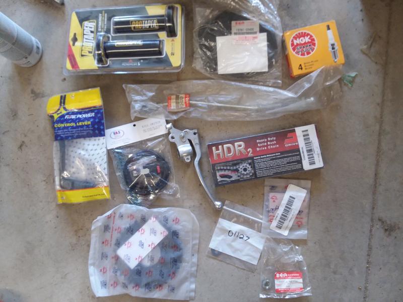

    The new parts pile
    80s Suzuki DS80 rebuild has begun!-20200530_150516-jpg

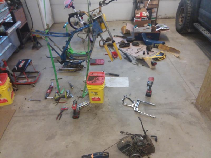

    Got her down to frame! Cleaned everything with a pressure washer a tub of soapy water. Oil tank had 1/4" of sludge on it. Decided without sandblasting the frame, id never get it good enough to paint so im leaving it.
    80s Suzuki DS80 rebuild has begun!-20200607_110500-jpg

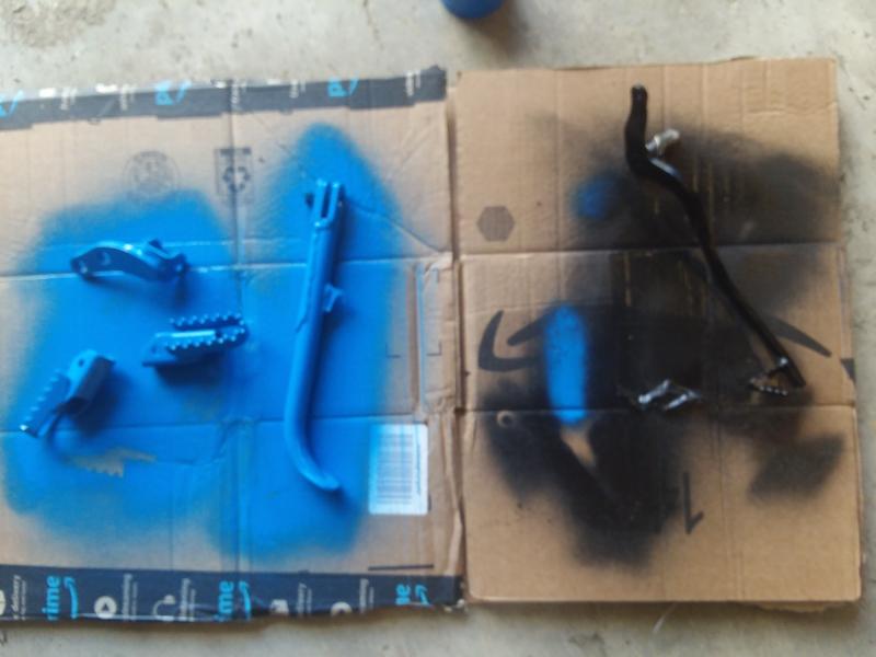

    Painted a few bits I could wire wheel good.
    80s Suzuki DS80 rebuild has begun!-20200607_183453-jpg

    You could try some Paint stripper. I’ve used the citrus based stuff before and it worked well

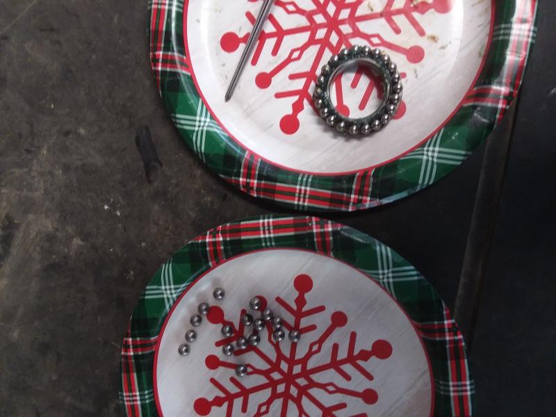

    80s Suzuki DS80 rebuild has begun!-20200609_124402-jpg
    Cleaning up and repacking the steering head bearings. The lower balls went EVERYWHERE on disassembly!

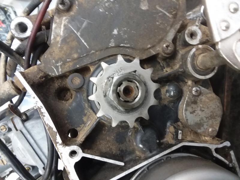

    80s Suzuki DS80 rebuild has begun!-20200609_160428-jpg
    80s Suzuki DS80 rebuild has begun!-20200609_161036-jpg

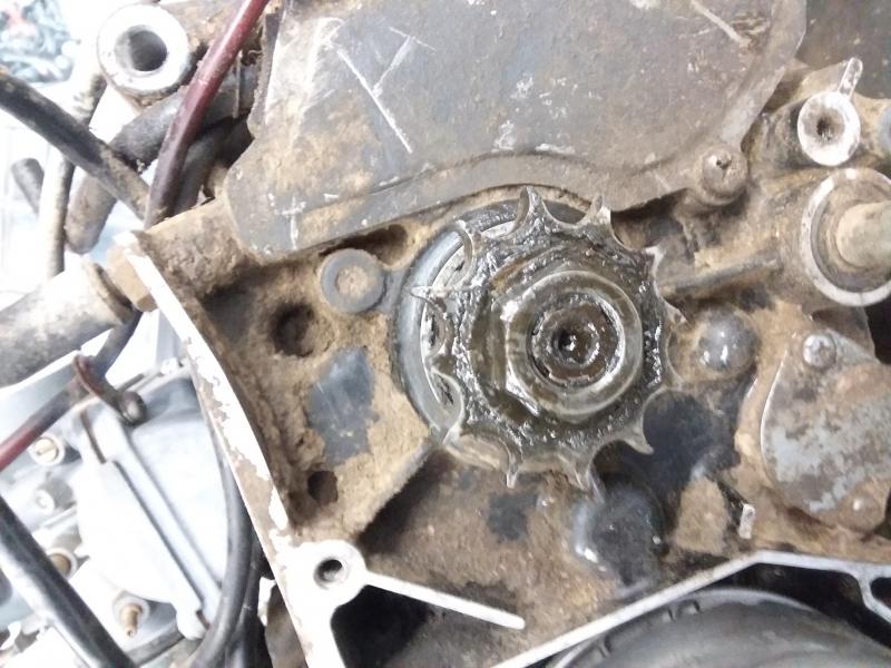

    New sprocket vs old sprocket!
