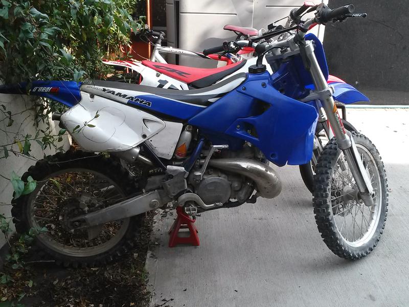

    $800 death bike
    goal: desert bike!
    I'll do the top end/maintenance and see how I feel on it...it's a bit powerful, so not sure it's for me...
    but for $800, I can likely break even including the new top end

    When tuned properly, that's actually a very user friendly bike. A friend of mine had a '99, and it was the smoothest 2stroke I'd ever ridden prior to my 250xc-w. His had a pro-circuit works pipe. play with the needle and clip position. Richer is friendlier, and leaner is meaner. It's amazing what a difference jetting makes with these things.

    Sweet deal. I would have jumped on it too.

    You've seen my WReck, it was $700... that is new enough that there is good aftermarket support for it still.
    Now, find me an aluminum frame YZ250 that's totally trashed the engine so I can swap my 92 in...

    Between the flywheel weight and the slightly richer jetting, (again focusing on the needle), I think you'll be really happy. When you do the top-end, you can double up on the base gaskets to numb it further. FWIW, I'm way more scared when riding 85s than 250s!
