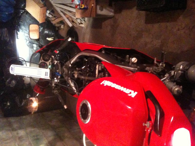

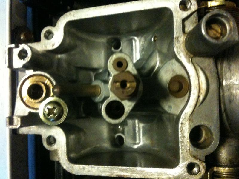

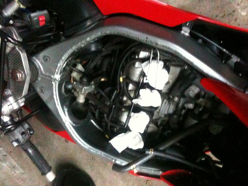

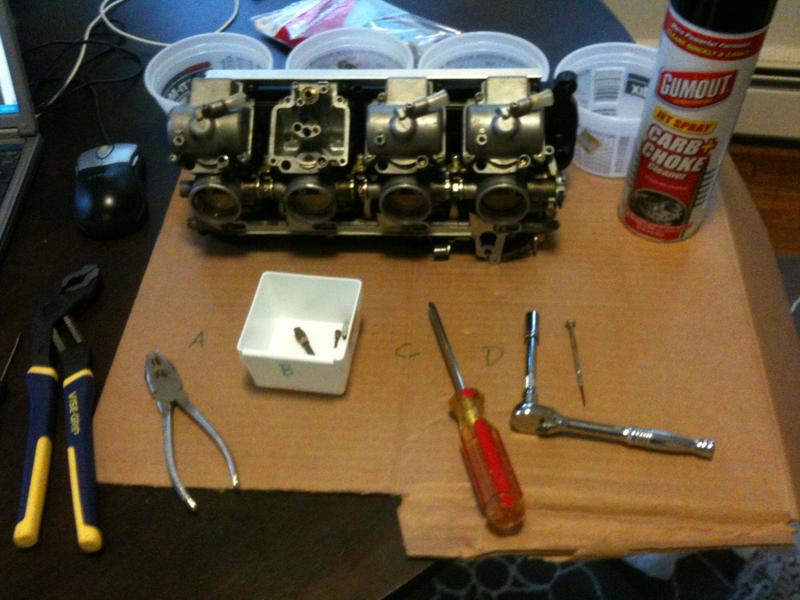

    The carb cleaning was way more time consuming than I thought it would be, but most of that was because I had never done one before. It took me ~ 10 hours (don't laugh), but I bet I could do it in about 3 hours now that I know how. The hardest part by far was removing the throttle cable (mostly because the previous owner had stripped a crucial screw, so I had to take the entire throttle assembly off the handle bar). Apparently old Japanese bikes use JIS screws, which a regular phillips will easily strip. As far as remembering which screws went where, I took lots of pictures as I went along and put organized them in containers/plastic bags (either by cylinder or by major component). Most of my organization wasn't even necessary, since the hoses sort of fall into place and the bolts/screws often only fit in the one place they need to. Also, I found an awesome little roll of brass wire at my hardware store that made cleaning the jets very easy. Oh, and word to the wise, don't get carb cleaner on any of the non-metal parts of the carbs (and definitely don't soak the parts in plastic/rubber containers). Like an idiot, I started soaking the parts in plastic containers, but quickly switched them to some fancy wine glasses that I never use.

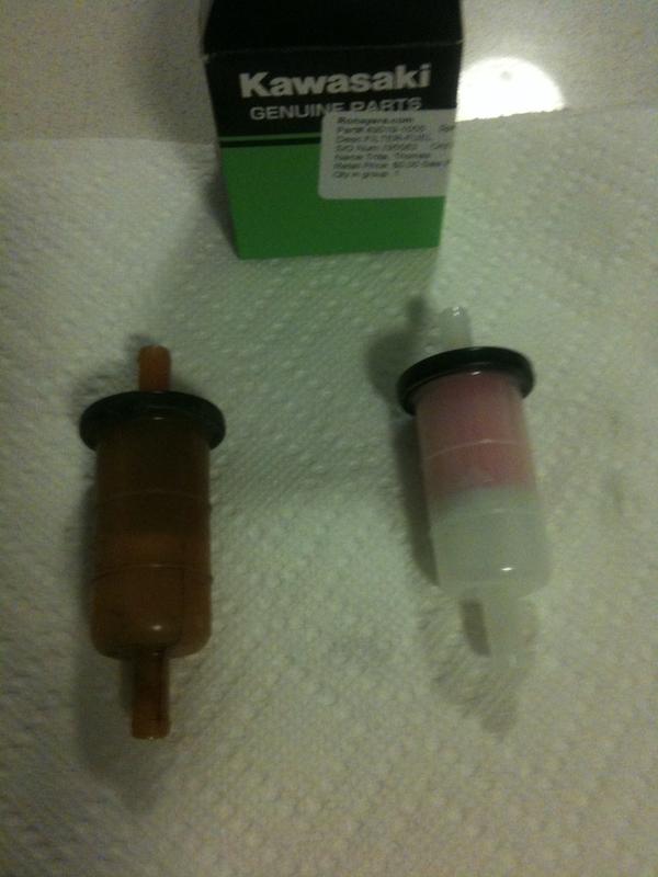

    I forgot to mention, I also switched out the fuel filter - took all of 3 minutes. Old and busted, meet new hotness:
    Carb Clean/Sync on 1996 ZX6R-fuel-filter-jpg
