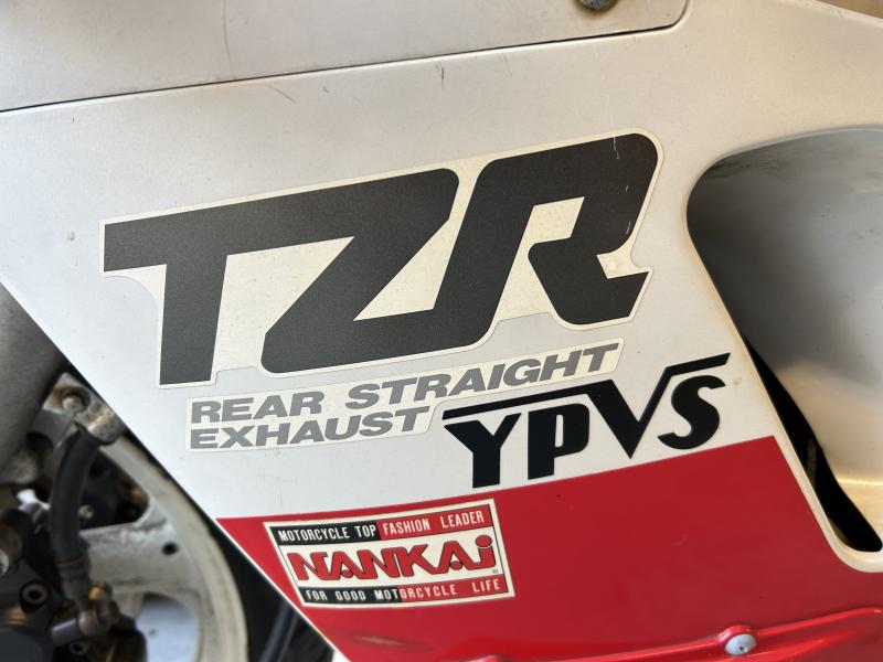

    Unlike the R7, this one is a complete running bike. It does need a full restoration, but it does run strong.

    Is it a japanese market bike? The TZR was an interesting replica. normal parallel twin, reversed parallel and V twin variants. I take it this is the reversed parallel by the sticker.
    It’s a Japanese import, reversed parallel twin.

    What the heck is a reverse parallel twin?
    Intake at the front, exhaust at the back, I assume? Kinda wonder why they aren't all like that. Probably prefer a certain length of exhaust?
    13,584
    Re: Bad decision #2
    It's a packaging PITA. Intake in the normal spot and you're dealing with an airbox and plumbing to it, typically short, it's all low pressure and feeding ambient temp air. Exhaust is hot, with some pressure, and needs length. When you go 'reverse' cylinder getting that exhaust out to the back while ALSO not cooking everything around it, having room for a fuel tank, frame, electronics, etc becomes a much harder problem for a pretty minor gain in most applications. Outside race applications the potential gains don't outweigh the costs to get there, which is why in modern settings the only place you're seeing it now is on one brand of MX bikes, and that's partially 'cause it counts as a sales distinguishing feature more than actual perf gains.
