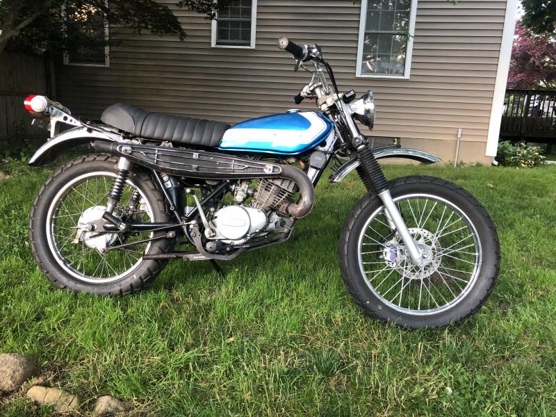

    This might not be the thread, but my wife got her motorcycle license and I bought something for her as a gift. You might know I’ve had a pattern of buying bikes for her and taking them, but this is really for her. And it’s a street legal 2 stroke. street legal 2-strokes-98580d3b-1f1c-46dc-b1b6-4b67a2b1d9f4
    1972 TS185
    With a more modern front end??? Those are not the stock 1972 forks/brake.
    It has a fork from a TTR125. The swap isn't quite right, but I'm working on making it better. The spacers aren't good and it needs to be resprung.

    This is exactly the right place, that thing is rad!
    My friend had one in high school and he used to jump the S out of it haha
    Welcome to the smoking club
